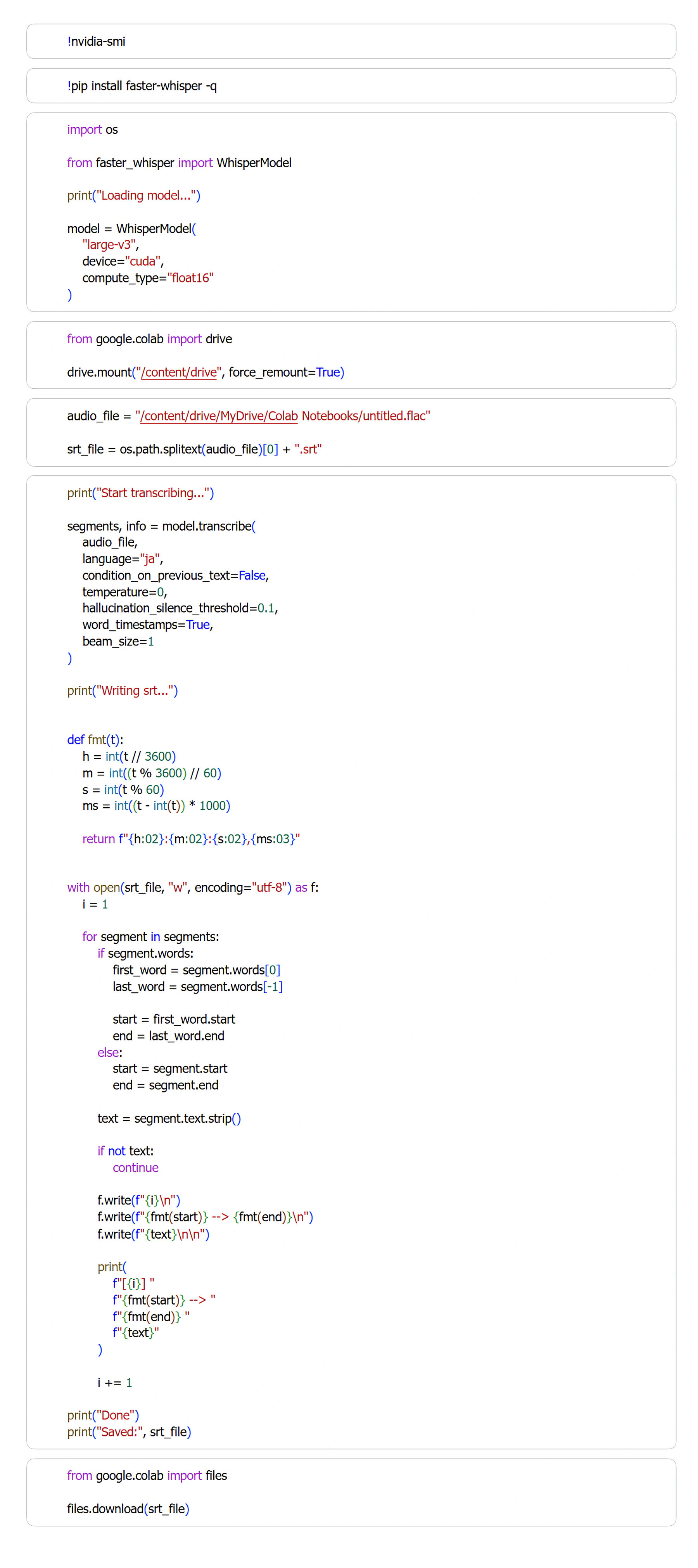

ถอดซับ
### เซลล์ 1 ###
!nvidia-smi
### เซลล์ 2 ###
!pip install faster-whisper -q
### เซลล์ 3 ###
import os
from faster_whisper import WhisperModel
print("Loading model...")
model = WhisperModel(
    "large-v3",
    device="cuda",
    compute_type="float16"
### เซลล์ 4 ###
from google.colab import drive
drive.mount("/content/drive", force_remount=True)
### เซลล์ 5 ###
audio_file = "/content/drive/MyDrive/Colab Notebooks/untitled.flac"
srt_file = os.path.splitext(audio_file)[0] + ".srt"
### เซลล์ 6 ###
print("Start transcribing...")
segments, info = model.transcribe(
    audio_file,
    language="ja",
    condition_on_previous_text=False,
    temperature=0,
    hallucination_silence_threshold=0.1,
    word_timestamps=True,
    beam_size=1
print("Writing srt...")
def fmt(t):
    h = int(t // 3600)
    m = int((t % 3600) // 60)
    s = int(t % 60)
    ms = int((t - int(t)) * 1000)
    return f"{h:02}:{m:02}:{s:02},{ms:03}"
with open(srt_file, "w", encoding="utf-8") as f:
    i = 1
    for segment in segments:
        if segment.words:
            first_word = segment.words[0]
            last_word = segment.words[-1]
            start = first_word.start
            end = last_word.end
        else:
            start = segment.start
            end = segment.end
        text = segment.text.strip()
        if not text:
            continue
        f.write(f"{i}\n")
        f.write(f"{fmt(start)} --> {fmt(end)}\n")
        f.write(f"{text}\n\n")
        print(
            f"[{i}] "
            f"{fmt(start)} --> "
            f"{fmt(end)} "
            f"{text}"
        i += 1
print("Done")
print("Saved:", srt_file)
### เซลล์ 7 ###
from google.colab import files
files.download(srt_file)

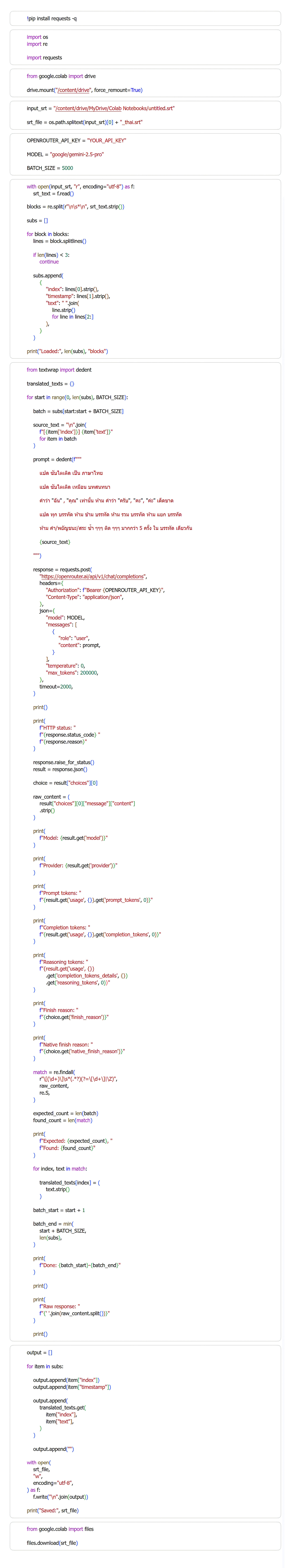

แปลซับ
### เซลล์ 1 ###
!pip install requests -q
### เซลล์ 2 ###
import os
import re
import requests
### เซลล์ 3 ###
### เซลล์ 4 ###
input_srt = "/content/drive/MyDrive/Colab Notebooks/untitled.srt"
srt_file = os.path.splitext(input_srt)[0] + "_thai.srt"
### เซลล์ 5 ###
OPENROUTER_API_KEY = "YOUR_API_KEY"
MODEL = "google/gemini-2.5-pro"
BATCH_SIZE = 5000
### เซลล์ 6 ###
with open(input_srt, "r", encoding="utf-8") as f:
    srt_text = f.read()
blocks = re.split(r"\n\s*\n", srt_text.strip())
subs = []
for block in blocks:
    lines = block.splitlines()
    if len(lines) < 3:
        continue
    subs.append(
            "index": lines[0].strip(),
            "timestamp": lines[1].strip(),
            "text": " ".join(
                line.strip()
                for line in lines[2:]
print("Loaded:", len(subs), "blocks")
### เซลล์ 7 ###
from textwrap import dedent
translated_texts = {}
for start in range(0, len(subs), BATCH_SIZE):
    batch = subs[start:start + BATCH_SIZE]
    source_text = "\n".join(
        f"[{item['index']}] {item['text']}"
        for item in batch
    prompt = dedent(f"""
        แปล ซับไตเติล เป็น ภาษาไทย
        แปล ซับไตเติล เหมือน บทสนทนา
        คำว่า "ฉัน" , "คุณ" เท่านั้น ห้าม คำว่า "ครับ", "คะ", "ค่ะ" เด็ดขาด
        แปล ทุก บรรทัด ห้าม ข้าม บรรทัด ห้าม รวม บรรทัด ห้าม แยก บรรทัด
        ห้าม คำ/พยัญชนะ/สระ ซ้ำ ๆๆๆ ติด ๆๆๆ มากกว่า 5 ครั้ง ใน บรรทัด เดียวกัน
        {source_text}
    response = requests.post(
        "https://openrouter.ai/api/v1/chat/completions",
        headers={
            "Authorization": f"Bearer {OPENROUTER_API_KEY}",
            "Content-Type": "application/json",
        json={
            "model": MODEL,
            "messages": [
                    "role": "user",
                    "content": prompt,
            "temperature": 0,
            "max_tokens": 200000,
        timeout=2000,
    print()
    print(
        f"HTTP status: "
        f"{response.status_code} "
        f"{response.reason}"
    response.raise_for_status()
    result = response.json()
    choice = result["choices"][0]
    raw_content = (
        result["choices"][0]["message"]["content"]
        .strip()
    print(
        f"Model: {result.get('model')}"
    print(
        f"Provider: {result.get('provider')}"
    print(
        f"Prompt tokens: "
        f"{result.get('usage', {}).get('prompt_tokens', 0)}"
    print(
        f"Completion tokens: "
        f"{result.get('usage', {}).get('completion_tokens', 0)}"
    print(
        f"Reasoning tokens: "
            .get('completion_tokens_details', {})
            .get('reasoning_tokens', 0)}"
    print(
        f"Finish reason: "
        f"{choice.get('finish_reason')}"
    print(
        f"Native finish reason: "
        f"{choice.get('native_finish_reason')}"
    match = re.findall(
        r"\[(\d+)\]\s*(.*?)(?=\[\d+\]|\Z)",
        raw_content,
        re.S,
    expected_count = len(batch)
    found_count = len(match)
    print(
        f"Expected: {expected_count}, "
        f"Found: {found_count}"
    for index, text in match:
        translated_texts[index] = (
            text.strip()
    batch_start = start + 1
    batch_end = min(
        start + BATCH_SIZE,
        len(subs),
    print(
        f"Done: {batch_start}-{batch_end}"
    print()
    print(
        f"Raw response: "
        f"{' '.join(raw_content.split())}"
    print()
### เซลล์ 8 ###
output = []
for item in subs:
    output.append(item["index"])
    output.append(item["timestamp"])
    output.append(
        translated_texts.get(
            item["index"],
            item["text"],
    output.append("")
with open(
    srt_file,
    "w",
    encoding="utf-8",
) as f:
    f.write("\n".join(output))
### เซลล์ 9 ###

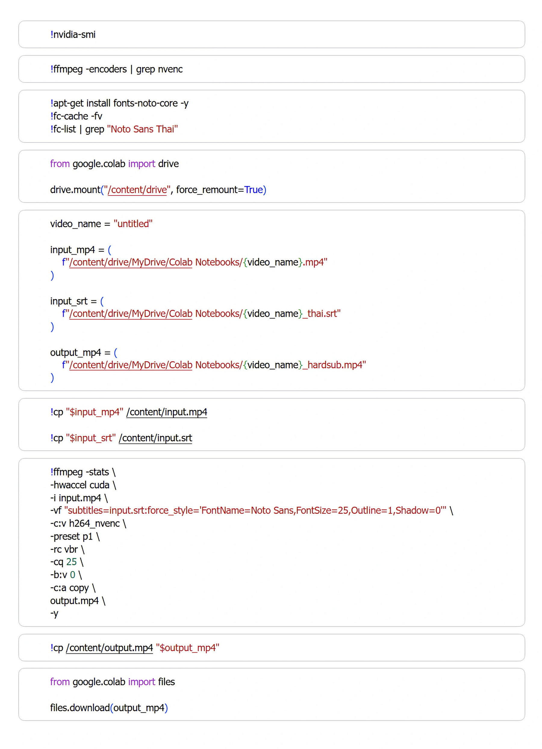

ฝังซับ
### เซลล์ 1 ###
!nvidia-smi
### เซลล์ 2 ###
!ffmpeg -encoders | grep nvenc
### เซลล์ 3 ###
!apt-get install fonts-noto-core -y
!fc-cache -fv
!fc-list | grep "Noto Sans Thai"
### เซลล์ 4 ###
### เซลล์ 5 ###
video_name = "untitled"
input_mp4 = (
    f"/content/drive/MyDrive/Colab Notebooks/{video_name}.mp4"
input_srt = (
    f"/content/drive/MyDrive/Colab Notebooks/{video_name}_thai.srt"
output_mp4 = (
    f"/content/drive/MyDrive/Colab Notebooks/{video_name}_hardsub.mp4"
### เซลล์ 6 ###
!cp "$input_mp4" /content/input.mp4
!cp "$input_srt" /content/input.srt
### เซลล์ 7 ###
!ffmpeg -stats \
-hwaccel cuda \
-i input.mp4 \
-vf "subtitles=input.srt:force_style='FontName=Noto Sans,FontSize=25,Outline=1,Shadow=0'" \
-c:v h264_nvenc \
-preset p1 \
-rc vbr \
-cq 25 \
-b:v 0 \
-c:a copy \
output.mp4 \
-y
### เซลล์ 8 ###
!cp /content/output.mp4 "$output_mp4"
### เซลล์ 9 ###
files.download(output_mp4)
